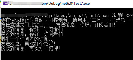

案例:

class Program{    static void Main(string[] args)    {        EventPublisher publisher = new EventPublisher();        EventSubscriber subscriber1 = new EventSubscriber();        EventSubscriber subscriber2 = new EventSubscriber();        // 订阅事件        subscriber1.Subscribe(publisher);        subscriber2.Subscribe(publisher);        // 发布事件        publisher.SendMessage("你好,订阅者们!");        Console.WriteLine("取消一个订阅者的订阅...");        // 取消订阅一个订阅者        subscriber1.Unsubscribe(publisher);        // 发布事件        publisher.SendMessage("再次打个招呼!");
       Console.ReadKey();    }}
输出:
